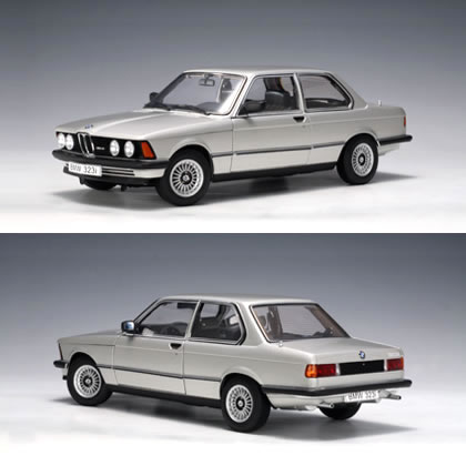

this is the donor model from AA in 1/18 scale
