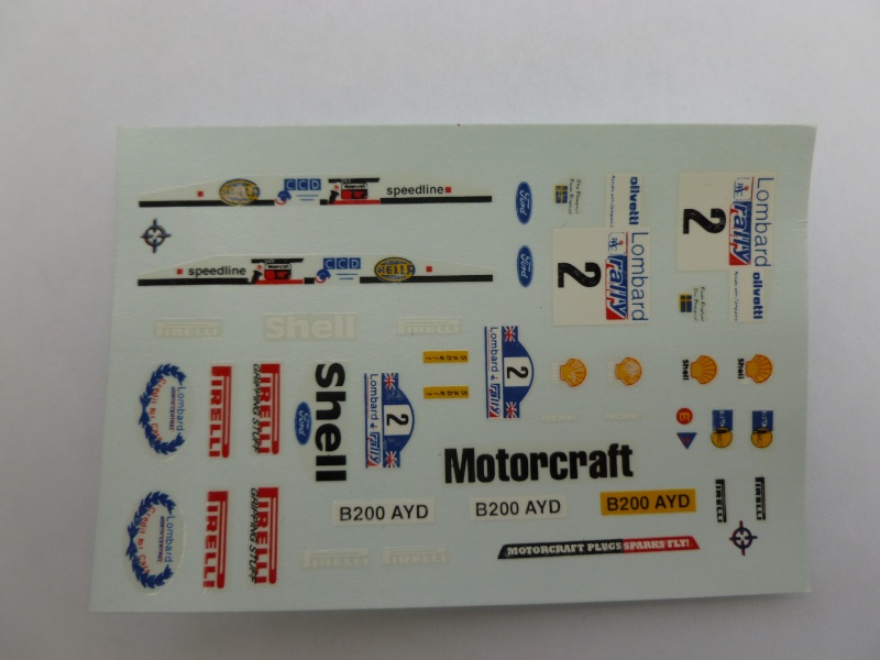

Thought i would post up my results on this .
I followed the tips on the link that Dave put up by placing the yellowed decals in a small celophane bag taped to the window in my conservatory in full sunlight.
I must admit I was a bit skeptical as to whether this would work but was amazed at the results;
Before;
Fix for Old Yellowed Decals? Before10
After 5 weeks;
Fix for Old Yellowed Decals? After_10
I put them in the conservatory on 26th February, and the 'After' pic was taken today.

Post  Cowley Wed Apr 03, 2013 3:33 pm
That's a stunning repair Simon, and I bet you're well pleased with the result!
I too had heard of this method but was similarly sceptical - UNTIL NOW! Wink
Is there any risk of them yellowing again after they have been removed from the sunlight though?
Fix for Old Yellowed Decals? Empty Re: Fix for Old Yellowed Decals?
Post  Simon6R4 Wed Apr 03, 2013 3:39 pm
Yeah really pleased with result David, as you say I was very skeptical too.
I don't know if they will yellow again if put away in the box again, I suspect they may well do. They had been stored in the box with the model since it was purchased some years ago.
I assume that if they are put on the model and the model is displayed in normal light then they will stay white?
To my mind it does rather throw into confusion the debate as to keeping your models away from sunlight for the fear of the decals yellowing, in this case it seems the opposite is true scratch
